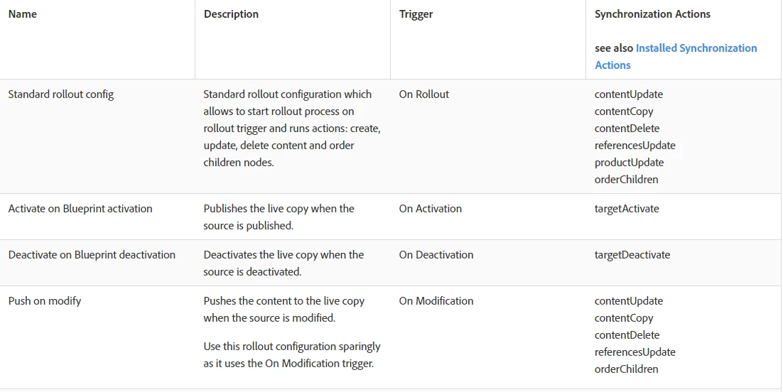

How to rollout newly created page to another country site or specific site only.
Is there any out-of-the-box/custom process available in AEM CS?.
Best answer by ShaileshBassi
@ramesh-hariThere are multiple rollout configs available in OOTB. Here is the list of the configs along with the description.  Based on how to want the changes to the pushed, you can select the respective rollout config.
Reference : https://experienceleague.adobe.com/docs/experience-manager-64/administering/introduction/msm-sync.html?lang=en
