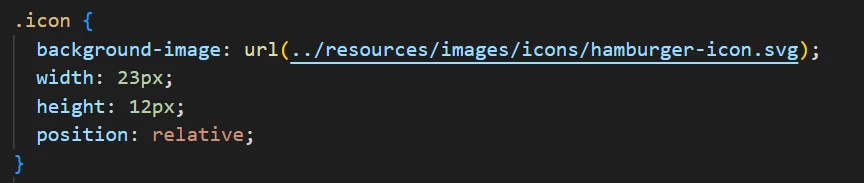

Hi @adobeaemsitesuser Can you please share the relative url which you are using. Tried at my end and the relative urls in ui.frontend for the svg/png icons are working as expected.
PFB the way the relative url was used within the project for icons
Uploading to DAM is also possible but in that case you need to leverage the dialog or design dialog for taking the input as the author will get the ability to change the location and can even delete the icons intentionally or un-intentionally.
If you are going via this option, you need to ensure that the HTL code is adjusted accordionly if the icons are not selected by the author or the icon is selected by later removed.
Hope this helps!
