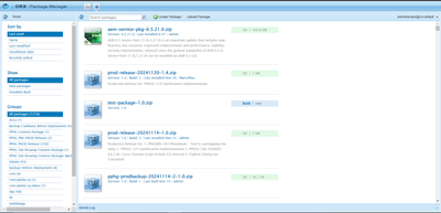

@aanchal-sikka  I have tested it with my local and other dev environment, it worked and all of the bundles are active. Currently I am using the backup of the dev env and have uploaded the package and it's said "A different version seems to be installed: 6.5.5", could this be the issue?
@MR_Nurfajri
Yes,
1. that warning message says that the installed package is not version 21, and,
2. The install button is enabled,
Indicates that the package version is not installed. Could you please try installing it and see if you are still experiencing problems.

I have tried to install it and here's the result
1. got  popup that says it could not install the package with reason "undefined"
 2. after i refreshed the crx it is installed
 3. on bundles there's a "updater.fake.bundle" that can't be resolved
 4. when i access the base url it returned 404
