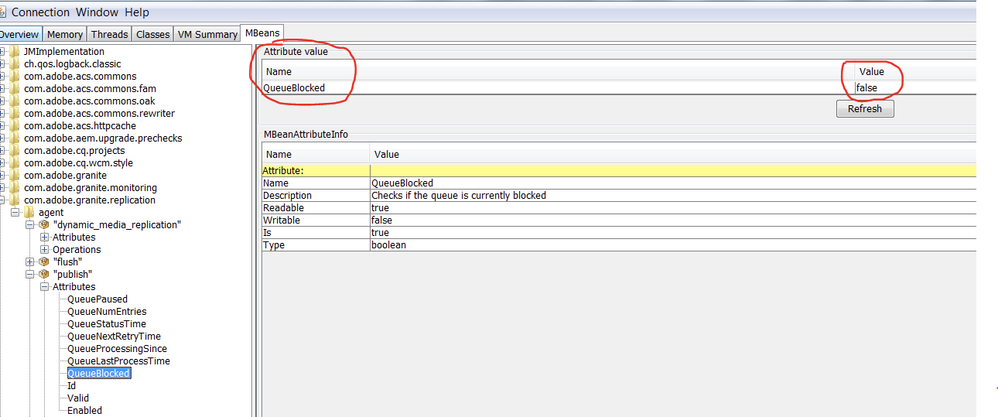

We are using AEM 6.4 and trying to monitor replication agent using any JMX plugin for example check_jmx plugin for nagios.
We have installed the check_jmx plugin in our monitor server and enable JMX connection in AEM server.
Now when testing from our monitoring server with below command we don't get expected attribute value which is true or false.
[root@MONITOR01 libexec]#  ./check_jmx -U service:jmx:rmi:///jndi/rmi://auth01:9000/jmxrmi -O com.adobe.granite.replication:type=agent,id="publish" -A QueueBlocked
JMX CRITICAL - com.adobe.granite.replication:type=agent,id=publish
But when we tried to check BackupReslut we get the expected value.Like this we wanted to check whether replication agent enabled true or false ,QueueBlocked true or false etc.
[root@MONITOR01 libexec]# ./check_jmx -U service:jmx:rmi:///jndi/rmi://auth01:9000/jmxrmi -O com.adobe.granite:type=Repository -A BackupResult
JMX OK - BackupResult=Backup completed
Please note that JMX started with port 9000 in our setup.
Any suggestion ?
regards
Sina
we got the solution from here  java - JMX: Read attribute from Server - Stack Overflow .
[root@MONITOR01 libexec]# ./check_jmx -U service:jmx:rmi:///jndi/rmi://auth01:9000/jmxrmi -O com.adobe.granite.replication:type=agent,id=\"publish\" -A QueueBlocked
JMX OK - QueueBlocked=false

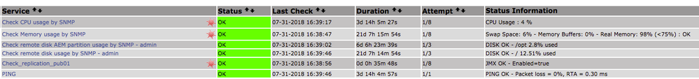

Monitoing in nagios
