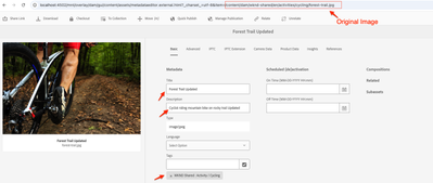

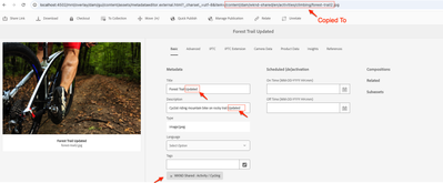

I was not able to reproduce what you are describing. Perhaps I did something wrong. What I did was update the metadata of an asset (title, description, tags) and then copy it to another folder, all using the UI. The metadata transferred as expected.
Original:
Copy:
As the documentation you shared states, the metadata is transferred to the copy as expected because it is not unique to the asset (https://experienceleague.adobe.com/en/docs/experience-manager-65/content/assets/managing/manage-asse...). What I suspect might be happening in your case is that some metadata is not allowed in the target location. Could you do a simple spot check by copying the image to a new folder outside your typical DAM folder structure and see if it behaves as expected? You can use the wknd folders as I did if you have those assets available to you.
Note I used AEM 6.5.17.
Hope this helps
