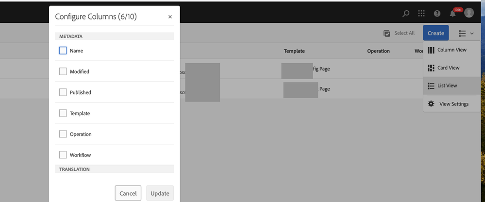

we report an anomaly found on AEM for both the "xyz project" and "zyx project" nodes (both dev and qa). When we select the content list view, we display the info columns for each node with the wrong header, therefore not corresponding to the data in the column. For example, in the "Published" column we display the content templates, in the "Template" column there is no information, in the "Modified" column there is information about the publication instead of the modification.

Hi @arunpatidar
I tried and getting same result. Please refer ss
Hi @Sai1278

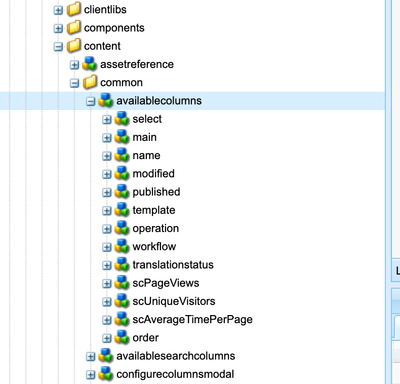

I think the Operation is messing up with the ordering. What I can see in our instances Operation as the last as per list

Hi @Sai1278
Can you please check following for below path
/libs/wcm/core/content/coral/common/configurecolumnsdialog/items/form/items/chooseColumns/datasource
1. did you override either above path ? or cq/gui/components/siteadmin/admin/listview/columns/datasources/availablecolumnsdatasource in apps
2. what do you see at /libs/wcm/core/content/common/availablecolumns or is there override in apps for this path
For me datasource contains following nodes
