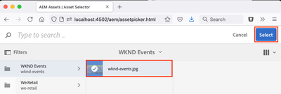

For Asset Selector, you can just call the AEM Assets instance at the following URL: /aem/assetpicker.html
This will bring up the Asset Selector UI. You can also provide parameters to control the dialog (see documentation).

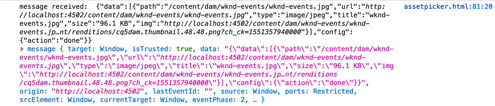

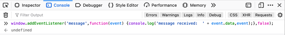

window.addEventListener('message',function(event) {console.log('message received: ' + event.data,event);},false); ​
  • Use the UI to select an asset and click the "Select" button on the top right
  • The received message will be logged to your browsers developer console:
message received: {"data":[{"path":"/content/dam/wknd-events/wknd-events.jpg","url":"http://localhost:4502/content/dam/wknd-events/wknd-events.jpg","type":"image/jpeg","title":"wknd-events.jpg","size":"96.1 KB","img":"http://localhost:4502/content/dam/wknd-events/wknd-events.jp…nt/renditions/cq5dam.thumbnail.48.48.png?ch_ck=1551357940000"}],"config":{"action":"done"}} message { target: Window, isTrusted: true, data: "{\"data\":[{\"path\":\"/content/dam/wknd-events/wknd-events.jpg\",\"url\":\"http://localhost:4502/content/dam/wknd-events/wknd-events.jpg\",\"type\":\"image/jpeg\",\"title\":\"wknd-events.jpg\",\"size\":\"96.1 KB\",\"img\":\"http://localhost:4502/content/dam/wknd-events/wknd-events.jp…nt/renditions/cq5dam.thumbnail.48.48.png?ch_ck=1551357940000\"}],\"config\":{\"action\":\"done\"}}", origin: "http://localhost:4502", lastEventId: "", source: Window, ports: Restricted, srcElement: Window, currentTarget: Window, eventPhase: 2, … }​

To get a feeling on how things work you may want to try it:
