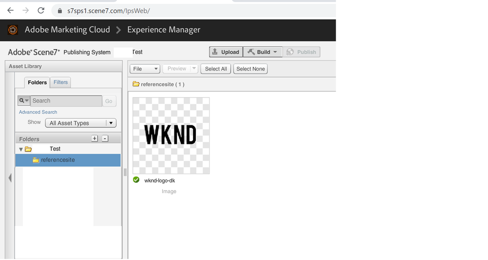

Dear All,
I am following below adobe guideline and integrated dynamic media with my AEM local
https://docs.adobe.com/content/help/en/experience-manager-65/assets/dynamic/config-dms7.html
1) I have created dynamic cloud config , as shown below.
2) Then I have selected sync everything in this sub folder to dynamic media, as shown below.
3) But the images are not syncing in my dynamic media , as shown below.
Is that something , I am missing. Please let me know.
Best answer by Shashi_Mulugu
@dipu2 sync to dynamic media will happen via a process step inside DAM Update Asset workflow.. you have to upload new assets inside the sync folder to make the assets sync.. it will not work for existing assets. If required run the workflow manually and check.

@232100, In the below response from you which one is the Sync folder,,sorry I did not get this one. Because I am looking here how to sync folder to dynamic media "or" in more detail...I have one folder called sunitatest in AEM asset and how can i sync this folder to dynamic media "or" Can I create the folder name as test (same name as given in dynamic media) to sync ?
