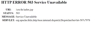

AEM6.5 local aem is throwing error AuthenticationSupport service missing
Level 8
I have done with local set up   using the below packages
aem-service-pkg-6.5.5.zip
com.adobe.fmdita-6.5-3.6.5.35.zip
com.adobe.fmdita-6.5-sp-3.6.6.41.zip
asset-share-commons.ui.apps-1.9.4.zip
and do some code changes using git repository and may shut down my system 3 times or 4 times then start my local set up does not log in and gives the following error .
For the url http://localhost:4502/
http://localhost:4502/crx/de/index.jsp
How to resolve it
I tried using  below, but does not solve the problem
https://experienceleaguecommunities.adobe.com/t5/adobe-experience-manager/while-starting-up-aem-inst...
Please provide inputs
Hi @srinivas_chann1
We have also faced the similar issue after installing the XML data addon in author instance. Author instance took more time than usual for the first time after installing this. Also please verify the technical requirements to install xml data on.
Technical requirements
Before installing XML Documentation for Adobe Experience Manager, ensure your system meets the
following technical requirements:
• Version 6.5 Service Pack 8 and 7
• Version 6.4 Service Pack 8 and 7
• Version 6.3 Service Pack 3
Please refer to the below link if it helps
https://helpx.adobe.com/content/dam/help/en/xml-documentation-solution/3-8-6/XML-Documentation-for-A...
Also please provide error log if still the issue exists. All the bundles are up and running?
