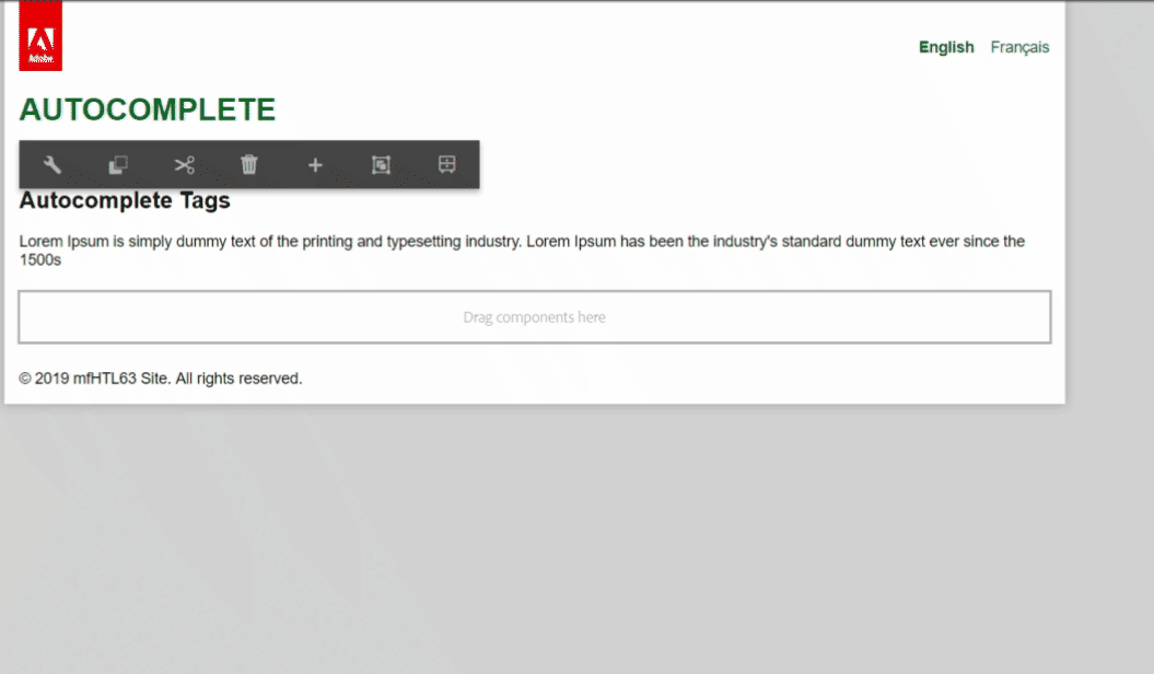

srinivas_chann1
Level 7
August 19, 2019
Thanks for your inputs again as you have now shared even a video .That really helps.
I noticed that setTimeout(() =>  this line was causing the issue for the dialog not to close .

arunpatidar
August 19, 2019
Hi Srinivas,
I did not get your question? could you please let us know, what issue are you facing now?
