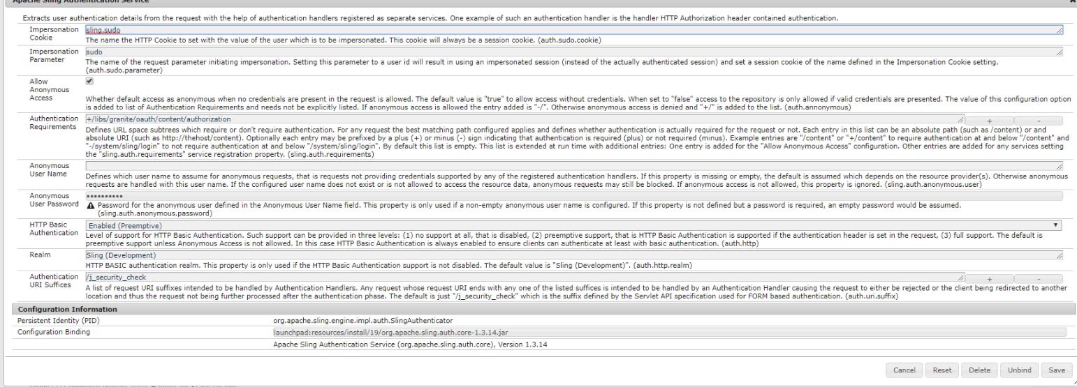

I'm using AEM 6.2 and I've already check user admin for anonymous user permissions.
Any suggestions?

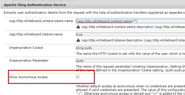

edubey
July 20, 2018
Can you check this particular config once, It should be checked
July 20, 2018
Yep, that's checked.

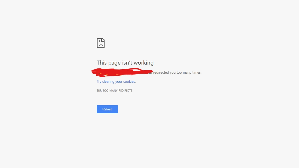

Hmm, I don't think so because If it would be an author instance it should redirect me tot the AEM login page.
But when I access any page I get this 403 error.

302 status code would suggest an issue on the apache level or resource mapping configuration. Can you bypass the webserver and directly try hitting the author/publish instance
