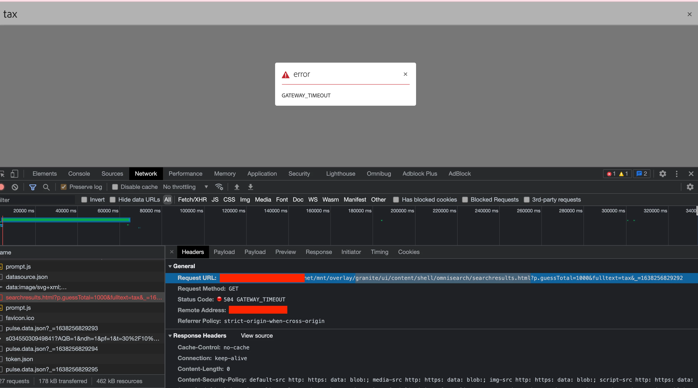

When we try to search a page in AEM it ends up in time out error. see screenshot below.
Not sure what could be the cause of this. we are using Adobe Experience Manager, Version 6.5

The Logs are showing this error.
