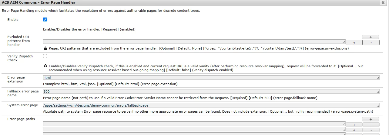

I was hoping to understand the reason for these errors in logs on page load in PROD (page loads perfectly fine on Browser) while the case is i dont see any error on trying to replicate the same in local.
17.01.2025 14:44:07.615 *ERROR* [66.249.77.69 [1737125047613] GET /content/sample/page/us/en/about.html HTTP/1.1] org.apache.jsp.libs.cq.Page.Page__002e__jsp resource has no content. path=/content/sample/page/us/en/about.html referrer=null
17.01.2025 15:36:28.122 *ERROR* [213.230.114.72 [1737128187960] GET /content/sample2/page/sg/en/capacity/solutions.html HTTP/1.1] com.adobe.acs.commons.errorpagehandler.impl.ErrorPageHandlerImpl Exception swallowed while including error page java.lang.NullPointerException: null
I tried to check within page.jsp file and Error Page Handler in ACS commons also the associated templates for any broken content but all seems to be fine.
Is this something i need to be concerned over the time as the pages are loading fine currently?
Please let me know if i am missing something.

@giuseppebaglio Thanks for the detailed explanation. After digging more i see the whole context and below are the details.
1. i think both these errors are related and the page mentioned in the logs is unpublished.
 *ERROR* [104.222.43.7 [1761040329772] GET /content/demo/example/gb/en/about/whereabouts.html HTTP/1.1] com.adobe.acs.commons.errorpagehandler.impl.ErrorPageHandlerImpl Exception swallowed while including error page
 *ERROR* [104.222.43.7 [1761040329772] GET /content/demo/example/gb/en/about/whereabouts.html HTTP/1.1] org.apache.jsp.libs.cq.Page.Page__002e__jsp resource has no content. path=/content/demo/example/gb/en/about/whereabouts.html referrer=null
2. Within the ACS Commons - Error page handler i dont have any error page path included for my DEMO project
3.but i have the errorpages property set to parent page en as below
Considering all this i think the resource not found error is due to the page not being published. and nullpointer exception is logged because of the error page path not included in acs handler for demo project and handler trying to check the fallback page . but eventually as part of hierarchy the ACS handler navigates to site specific error page property and renders the 404 page successfully in prod.
please suggest on how to avoid the NPE from getting logged every time the page is hit. or is there anything i am missing here.

hi @veena1,
Configure the errorPagePath or equivalent property in ACS Commons Error Page Handler specifically for your DEMO project, pointing to a published and accessible error page node. This ensures the handler always finds a valid resource, preventing the null lookup and therefore the NPE.
Also, ensure that all referenced error pages (both local and inherited via hierarchy) are published and have read permissions for anonymous users in the environment.

@giuseppebaglio i got your point its better to include errorpage path in ACS config.  But i would like to highlight that when i hit the /content/demo/example/gb/en/about/whereabouts.html in prod i see a 404 custom page rendered from the errorPage property
the root page en also has a 404 error page created under its hierarchy.
but the question here is the NPE getting logged because of the wrong value as it is pointing to /content/demo/example/gb/en only while the case is property should have been  /content/demo/example/gb/en/404
Again if this is the case of wrong path then how is the exact 404 page under en is getting rendered in prod. does ACS handler look for 404 error page by default under the specified path in errorpage property. like is this the default behaviour of ACS handler?
