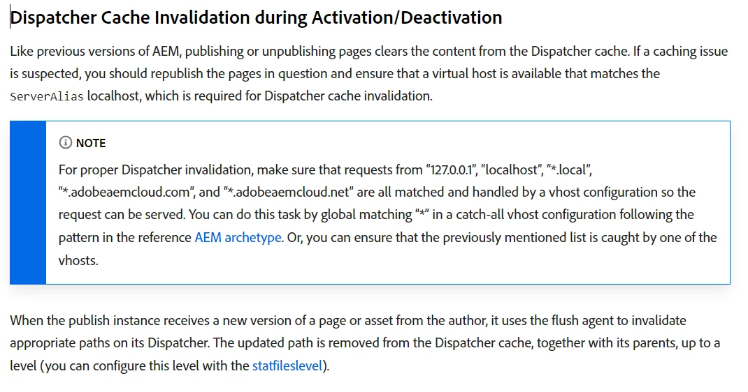

We're facing a challenging issue with our AEM as a Cloud project. Our caching had been working correctly for a long time, but recently we've noticed that content isn't refreshing after publishing or even after the max-age is reached. Below are our findings from the debugging we've done so far.
Additionally, our dispatcher cache settings haven't been changed in a very long time.
  1. As per the documentation https://experienceleague.adobe.com/en/docs/experience-manager-cloud-service/content/implementing/content-delivery/caching#cache-activation-deactivation , our vhost configurations appear to be correct.
