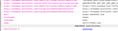

@arunpatidar thank you so much for your prompt response. SAML response from azure with group details matches with AEM group already configured. (using SAML tracer ) Please see below:
Also, note that I have <url>/system/console/configMgr component adobe granite SAML 2.0 Authentication Handler attribute Group Membership value as groups.
Tried value as group too, but no luck.
Hi @helloosuman
I can't see wild-west-group in the groups in the SAML response.

@arunpatidar as advised, I have tried with component adobe granite SAML 2.0 Authentication Handler attribute Group Membership value as groups or group also and component Apache Sling Referrer Filter attribute Filter Methods as POST, PUT, GET, DELETE. Still facing same issue. Please find attached doc with SAML response.
Hi @helloosuman
Can you check the
here the groups attribute name is http://schemas.microsoft.com/ws/2008/06/identity/claims/groups, so you may need to use same name in the config e.g.
groupMembership=http://schemas.microsoft.com/ws/2008/06/identity/claims/groups
or
groupMembership=profile/attributes/http://schemas.microsoft.com/ws/2008/06/identity/claims/groups
AEM LinksLinkedIn
@arunpatidar with groupMembership=http://schemas.microsoft.com/ws/2008/06/identity/claims/groups, it works now.
