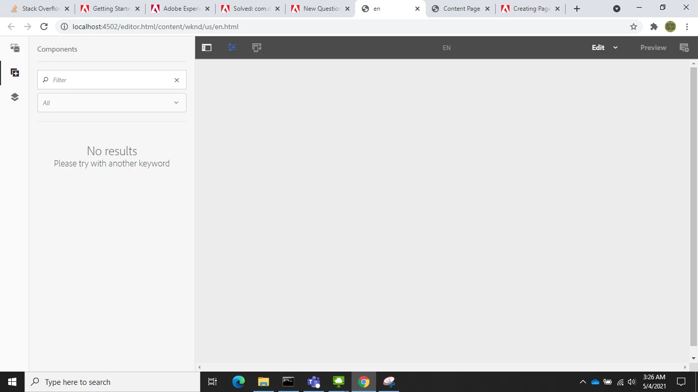

I installed a new AEM local instance AEM_6.5_Quickstart.jar. I started following wknd tutorial and created a project using maven archetype command given in project setup page of tutorial. I was able to create and install the project on my local instance however when i create first page as in tutorial and click on edit i dont see any layout container or components available in side rail.

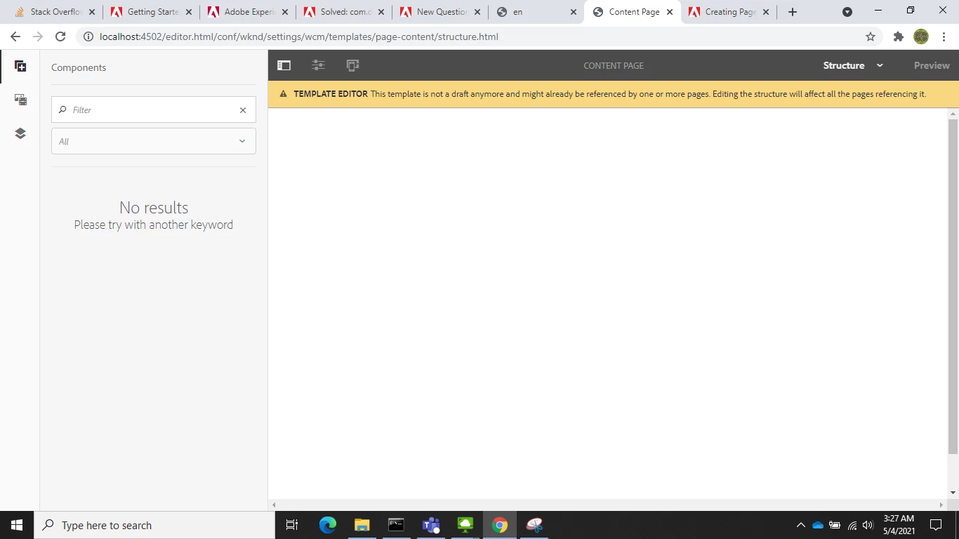

Tried to check the template but same issue there as well

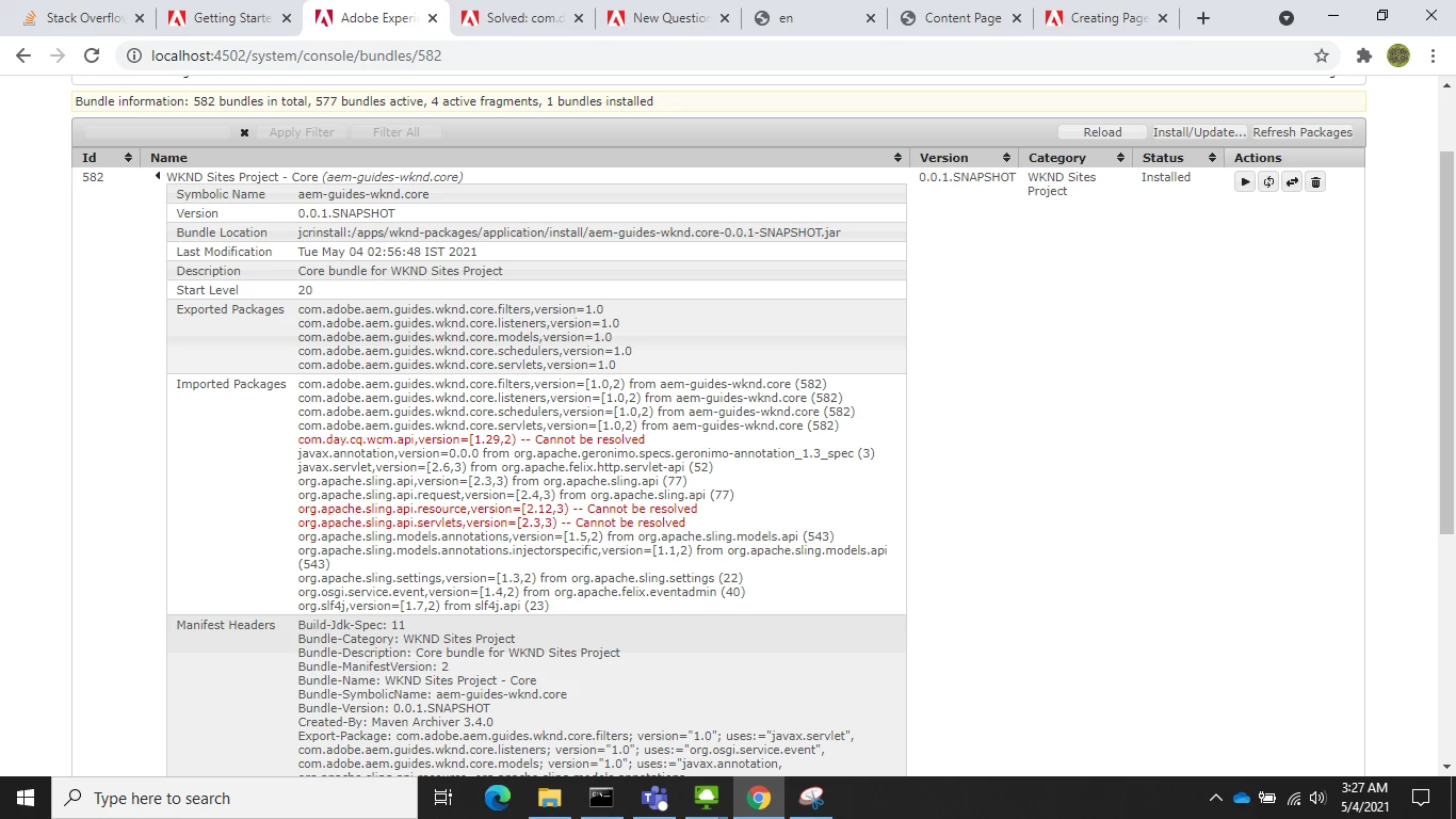

This is what i see in the console some dependencies are causing this issue?

Hi @shivam_s,
I suggest to check the Technical Requirements page for AEM. In particular, JVMhttps://experienceleague.adobe.com/docs/experience-manager-65/deploying/introduction/technical-requirements.html?lang=en#supported-platforms
Considering this, bring the AEM instance up with all bundles active in http://localhost:4502/system/console/bundles
+ no errors in error.log file ->  try accessing we-retail (sample content) site pages and can also try creating sample page within we-retail to test components (drag and drop)
If you have no issues so far, then work on WKND project - You can checkout the source code from this GitHub location - https://github.com/adobe/aem-guides-wknd -> Build/Install in your local. (As you are dealing with few other related issues, I suggest to resolve that and then work on WKND project)

couple of thing to be done initially
1. in osgi console check list of installed bundles (not started and not fragments) and try to start them based on IDs assigned
2. monitor the error.log for error while starting the bundle first and then will rendering the page. it will give you clue about what's happening
3. check the project package from /crx/packmgr/index.jsp and reinstall it again
4. restart the server again and check for the log for any error
(if still issue, fresh install rather debugging)

I tried to stop the local instance and delete the crx-quickstart and restart..i create the project and install it again and every time i ge the same problem no components and no layout container. I checked the log when i click on edit after selecting a page and this is the error i could see.
04.05.2021 03:53:29.413 *WARN* [0:0:0:0:0:0:0:1 [1620080609229] GET /editor.html/content/wknd/us/en.html HTTP/1.1] org.apache.sling.caconfig.resource.impl.def.DefaultConfigurationResourceResolvingStrategy Ignoring reference to /conf/wknd/settings from /conf/wknd/settings - Probably misconfigured as it ends with '/settings'
04.05.2021 03:53:29.424 *WARN* [0:0:0:0:0:0:0:1 [1620080609229] GET /editor.html/content/wknd/us/en.html HTTP/1.1] org.apache.sling.caconfig.resource.impl.def.DefaultConfigurationResourceResolvingStrategy Ignoring reference to /conf/wknd/settings from /conf/wknd/settings - Probably misconfigured as it ends with '/settings'
04.05.2021 03:53:29.653 *ERROR* [0:0:0:0:0:0:0:1 [1620080609628] GET /content/wknd/us/en.html HTTP/1.1] org.apache.sling.servlets.get.impl.DefaultGetServlet No renderer for extension html, cannot render resource JcrNodeResource, type=wknd/components/container, superType=null, path=/conf/wknd/settings/wcm/templates/page-content/structure/jcr:content/root
package manager shows the installed packages for wknd project all,content,config,apps. Tried restarting the jar and these are the only warnings i could see in error.log and no errors were present for restart.

Please find the dependencies in your pom.xml
1- what version of wknd tutorial you are installing
2- Go to your http://localhost:4502/system/console/depfinder
and enter the org.apache.sling.api.resource and click on Find
Package version should match to the entry in your pom.xml

Hello @sureshdhulipudi  i am installing from this link: https://github.com/adobe/aem-guides-wknd.
I checked the dependency for the org.apache.sling.api.resource and found the version as
When i search in parent pom.xml there is no such dependency present
