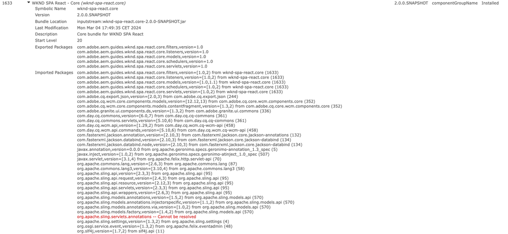

my AEM bundle is not starting on local due to "org.apache.sling.servlets.annotations -- Cannot be resolved".
I can't find any bundle exporting "org.apache.sling.servlets.annotations". The package is needed for using SlingServletFilter.
I wonder what I might miss because it was already running like 2 months ago and I haven't done any changes. I even installed the latest AEM SDK but still the same error.
Can you help please, how that missing bundle/package could be added?

Thanks @arunpatidar , i finally found the root cause, it seems.
bnd-maven-plugin gave this warning:
[INFO] --- bnd-maven-plugin:6.4.0:bnd-process (bnd-process) @ wknd-spa-react.core ---
[WARNING] /.../core/pom.xml [0:0]: No translation found for macro: componentGroupName
After i have set the componentGroupName property (seems like both empty value or adobe works), my deployed bundle is starting without missing package. I don't see what i had different in the past, because it used to work.
Anyway, thanks for the help.
Peter

The package is not exposed by any bundles:

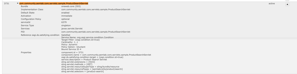

I do have the dependency added in the project with provided scope, but it's not provided on AEM:
Hi @arunpatidar ,
can you say which bundle does expose the package org.apache.sling.servlets.annotations by searching it at http://localhost:4502/system/console/depfinder or http://localhost:4502/system/console/bundles ?
This is supported with R7
maven-bundle-plugin 4.1.0+
you may need to check the bnd plugin
here is the servlet status
