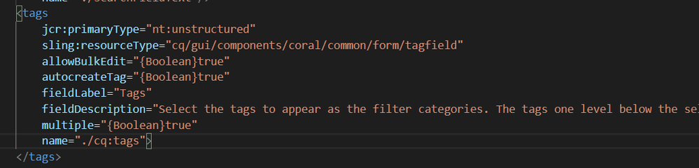

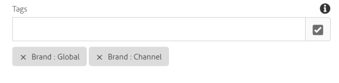

I'm working on a project that allows filterable tags. There are some tags I'd like to have populated by default, without the content creator having to find and select them. Is there a way to do that in the .context.xml dialog? Attached is my current code and what it looks like in the dialog box.
Use case: I have 2 tags selected. Is there a way to have them populated by default without having to click the checkbox and find them?

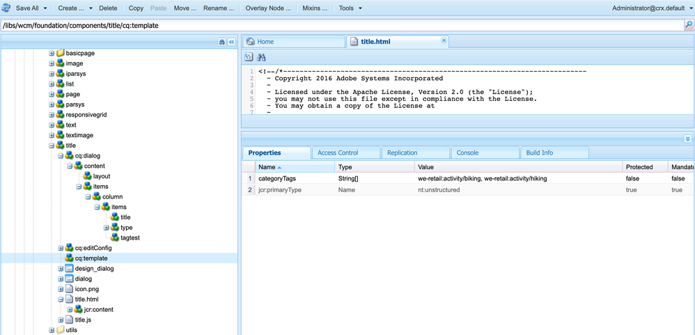

Yes, you can use cq:template node in the below component to populate default values.
cq:template has the type nt:unstructured, it allows you to define a complex node with a set of properties and children.
It's a node you create as a child of your component definition. This content will be used as default values whenever you drop a new instance of the component from the sidekick.

Hi @jsolano918 ,
Yes, I have tested it with we-retail tags and default title component by adding one more field of "tag".
I could not attach the package here but find the below screenshot.
