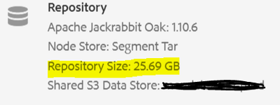

 Our current repository size is around 25GB. We have online compaction enabled which runs on daily basis, also offline compaction once in month. Does version purge helps to reduce the repository size by deleting versions from /jcr:system/jcr:versionStorage? How to verify whether repository size reduced or not? Does disk usage report helps to verify in case we have shared S3 data storage?
