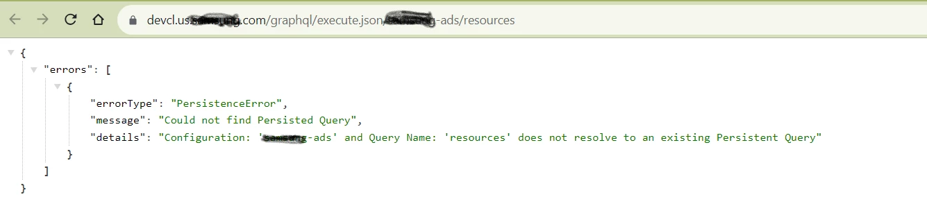

In the author and publish instances the persisted queries working fine. but on the dispatcher, it is not working.
I have added the below rules in the rewrite and dispatcher.any files
in rewrite file
RewriteCond %{REQUEST_URI} ^/graphql/execute.json RewriteRule ^/(.*)$ /$1;.json [PT]
in dispatcher.any
/0060 { /type "allow" /method '(POST|OPTIONS)' /url "/content/_cq_graphql/*/endpoint.json" }/0061 { /type "allow" /method '(GET|POST|OPTIONS)' /url "/graphql/execute.json*" }

October 27, 2023
Hi Anchal,
In the publish instance when I access the persisted query, I see JSON response and getting persistence error in the dispatcher, and in the network tab status is 404.
screenshot - dispatcher  status 404
screenshot - publish instance  status 200

Hi @n_radhakrishna, It seems like the request is being blocked by filters. To identify which filter rules are causing this, I suggest reviewing the dispatcher.log where you should be able to pinpoint the specific filter rules responsible for blocking the request.

The request was going to a different dispatcher and publish instance and I was working on another setup. We added above mentioned rewrite rules and dispatcher rules in our server setup and started working.
Thank you all.
