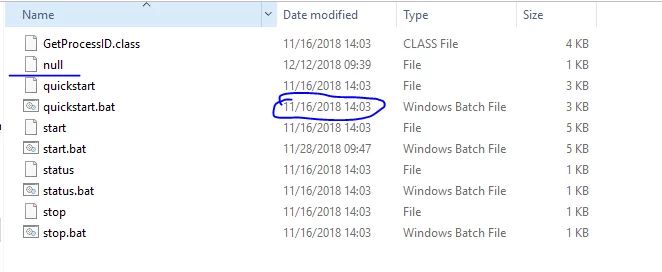

Noticed when starting AEM jar for first time. After I see the quickstart folder, I go to bin and hit the start.bat the instance starts, but at the same time a file named as 'null' is created.
Below is a snapshot of the folder view.
Below is the content of null file if opened with text editor
Error: Could not create the Java Virtual Machine.
Error: A fatal exception has occurred. Program will exit.
Unrecognized option: --add-modules
The instance works fine though.
Anyone faced similar issue?

Thanks Arun. using nul instead of null fixes the issue related to null file.
However I didn't mention in primary question. I also see the same error as mentioned in the link you added. Below is what I see.
