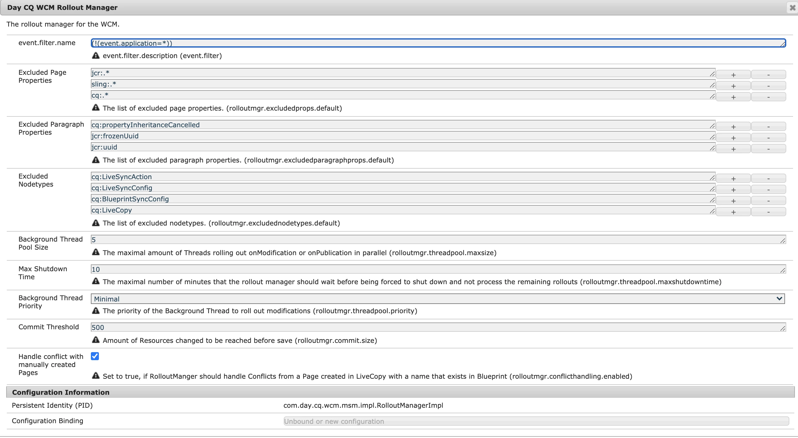

what is the recommendation on configuring this Day CQ WCM Rollout Manager in a similar use case.
Do you think, we should increase Background thread pool size from current 5 to count of geos (25),
and increase the current max shut down time from current 10 mins to to some higher value like 30 mins ?
