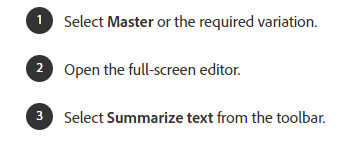

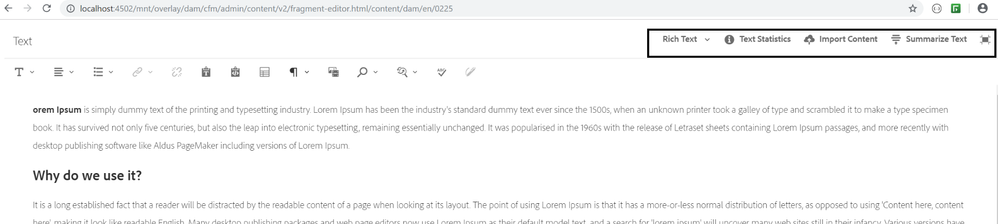

I am trying to add summarizing text to the Content Fragment according to this Variations - Authoring Fragment Content documentation. I am not getting any option as per the documentation. It says

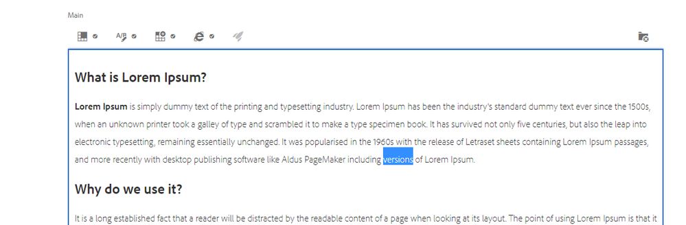

I don't see a full screen editor (I think that is the basic issue here .

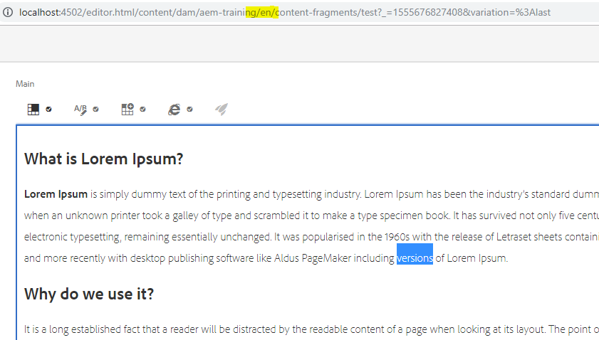

You can see it when the CF is inside a language folder.
The content fragment must have a valid language folder as an ancestor; this is used to determine the language model to be used.
For example, en/ as in the following path:
/content/dam/my-brand/en/path-down/my-content-fragment

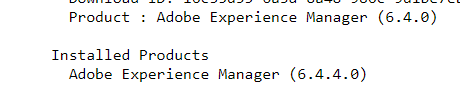

CF is inside the language folder . Only thing which is not matching the documentation is I have SP4 installed .
I'm also on SP4

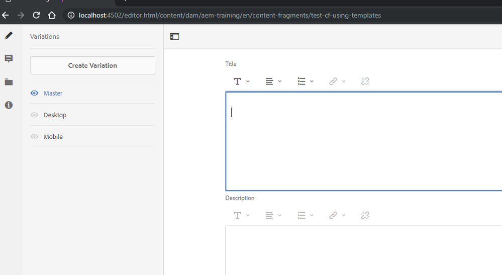

Even with the we-retail CF I am facing the same issue . I don't see text edit bars as in documentation and no option to go full screen . Also the variations action dropdown has only three values
Seems like it was working but due to browser cache I was seeing it differently. Checked incognito
