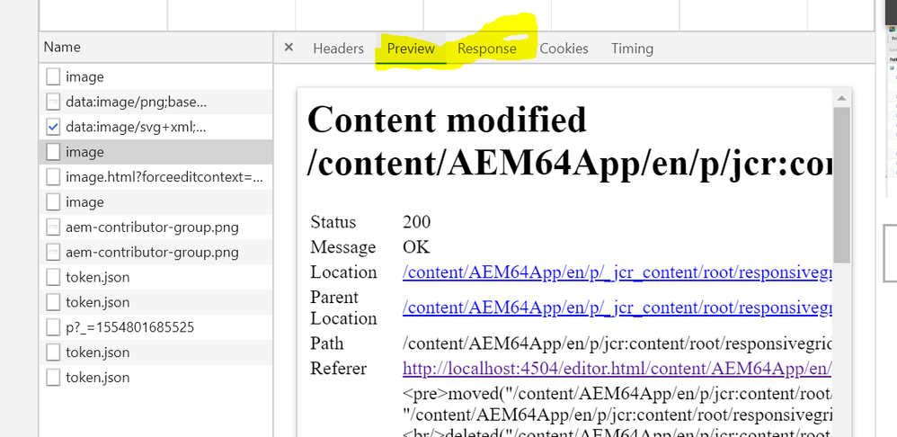

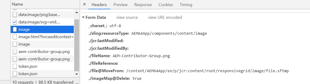

April 10, 2019
First, you need to find the request that is triggered when fileupload is used from "http://<host>:<port>/system/console/requests"
Once you have the request, use "http://<host>:<port>/system/console/servletresolver " to check which servlet gets invoked.
