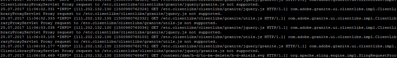

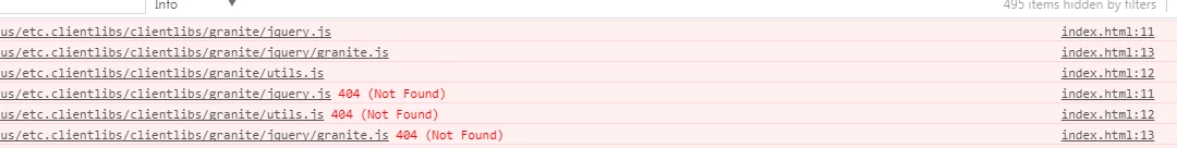

I finished to update the dispatcher for allow the proxy clientlibs but it didn't load when the domain is pointing to AEM publisher.
Error  404 in browser
Error in AEM publisher

I'm getting the same errors as OP on Publisher - hitting publish URL directly...
Anything with etc.clientlibs is throwing a 404 on the browser and AEM is generating the same ClientLibraryProxyServlet "not supported"

The 200 worked as expected and served the CSS file, the 404 also showed the 'proxy' error in the error.log on the Publisher:
25.08.2017 17:25:19.017 *INFO* [172.99.99.10 [1503696319015] GET /etc.clientlibs/clientlibs/granite/coralui3.css HTTP/1.1] com.adobe.granite.ui.clientlibs.impl.ClientLibraryProxyServlet Proxy request to /etc.clientlibs/clientlibs/granite/coralui3.css not supported.

I am getting the same issue , the /etc.clientlibs/ libraries work when accessed on port :4503 on publish instance, but when the request is through dispatcher on port 80, there is a 404 error response and the error in publish logs is -
com.adobe.granite.ui.clientlibs.impl.ClientLibraryProxyServlet Proxy request to /etc.clientlibs/clientlibs/granite/jquery.min.js not supported.
