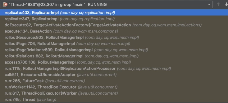

I investigated the empty ReplicationOptions thread using VisualVM:
[Thread-3788] com.day.cq.replication.impl.ReplicatorImpl Setting up replication with options:
ReplicationOptions{synchronous=false, revision='null', suppressStatusUpdate=false, suppressVersions=false, filter=null, aggregateHandler=null}
I see no custom code interfering, it seems like it's all part of the product.
Do you have any idea Jörg?
Your dump indicates to me, that the MSM rollout invokes the TargetActivateActionFactory, which invokes replication. And this replication might trigger all agents. But that seems no match to your initial problem description, because there I read it in this way: The invalidation agent (with on-modification trigger set) causes the "standard" replication to get fired.
Yes, when I enable it, it does trigger the other default replication for some reason. So it still seems like a bug to me.
