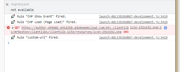

Hey guys,
I have an AEM site w/ the launch script installed following these guidelines https://experienceleague.adobe.com/docs/platform-learn/implement-in-websites/configure-tags/add-embed-code.html?lang=en

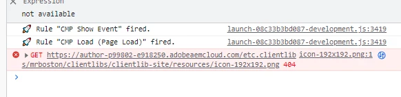

Unfortunately I'm facing an issue where certain events are not firing consistently across the site. For example I'll see the 'custom-url' event appear in the console after loading a page (using _satellite.setDebug(true)), but after a cache clear + refresh the event will no longer fire on load.
Because the behavior is inconsistent / varies on reload I'm assuming the root cause is a race condition... but I haven't had any luck in tracking down the code or setting that is responsible. I've included two screenshots -- the first showing a custom-url firing as expected, and the second showing a case where it's not firing. From investigating the adobeDataLayer object I can tell the custom-url event is being added correctly, seems like launch is just not recognizing it as it fires

Unfortunately switching to the synchronous implementation doesn't seem to solve the problem ... the events are still loading inconsistently
If that's not the issue you need to check the rules which are triggering "custom-url" event. Take a closer look at your DOM to identify any missing elements or attributes that could be causing the inconsistent behavior.
