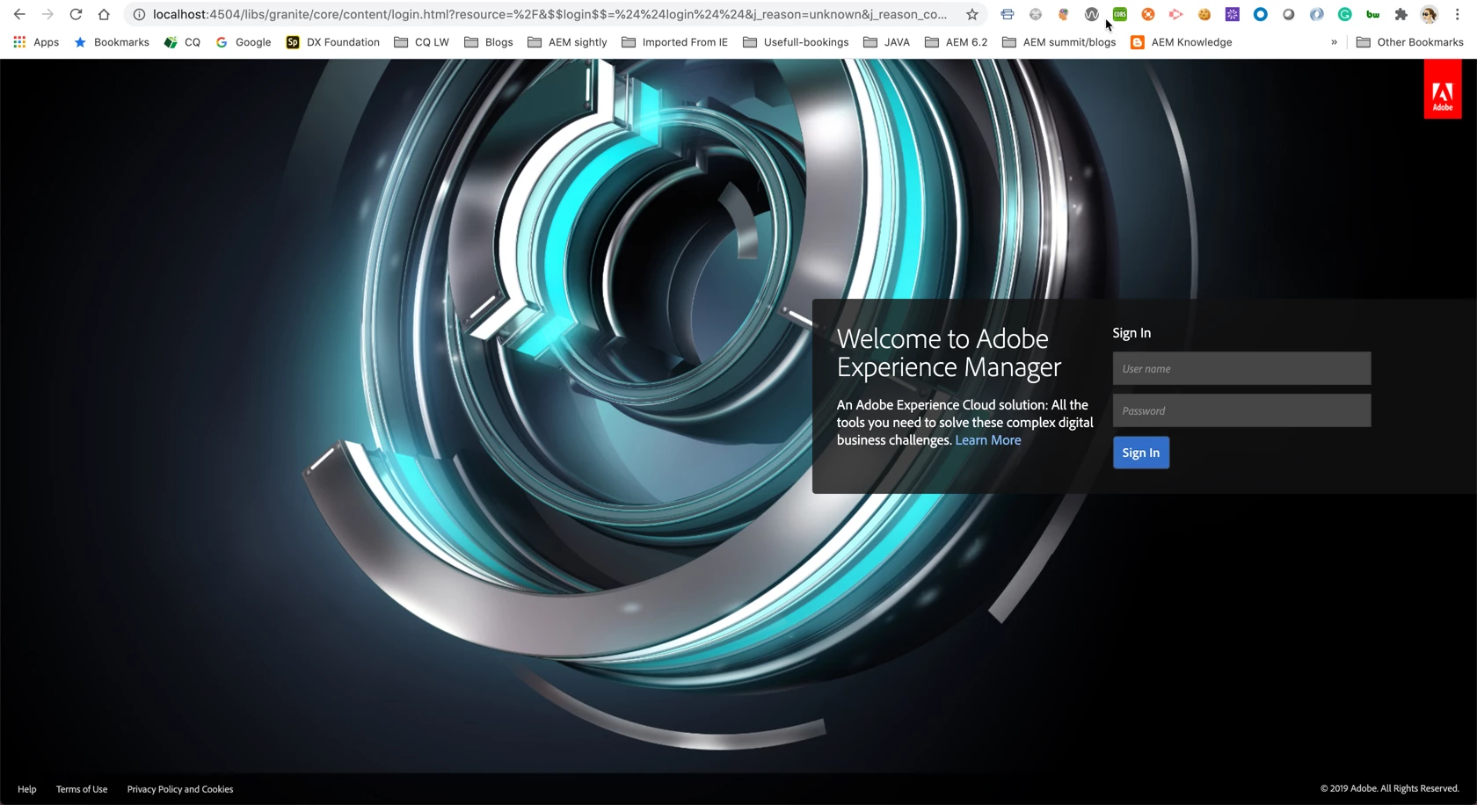

Try to run the jar as specified in the document by AEM you will be able to see the browser tab opening as seen in the below screenshot. In the below case, the port is 4504. If you're installing the AEM using the jar please check the jar name and find the port number by default it would be 4502.

If not and you installed AEM then you can access AEM using https://localhost:4502/
