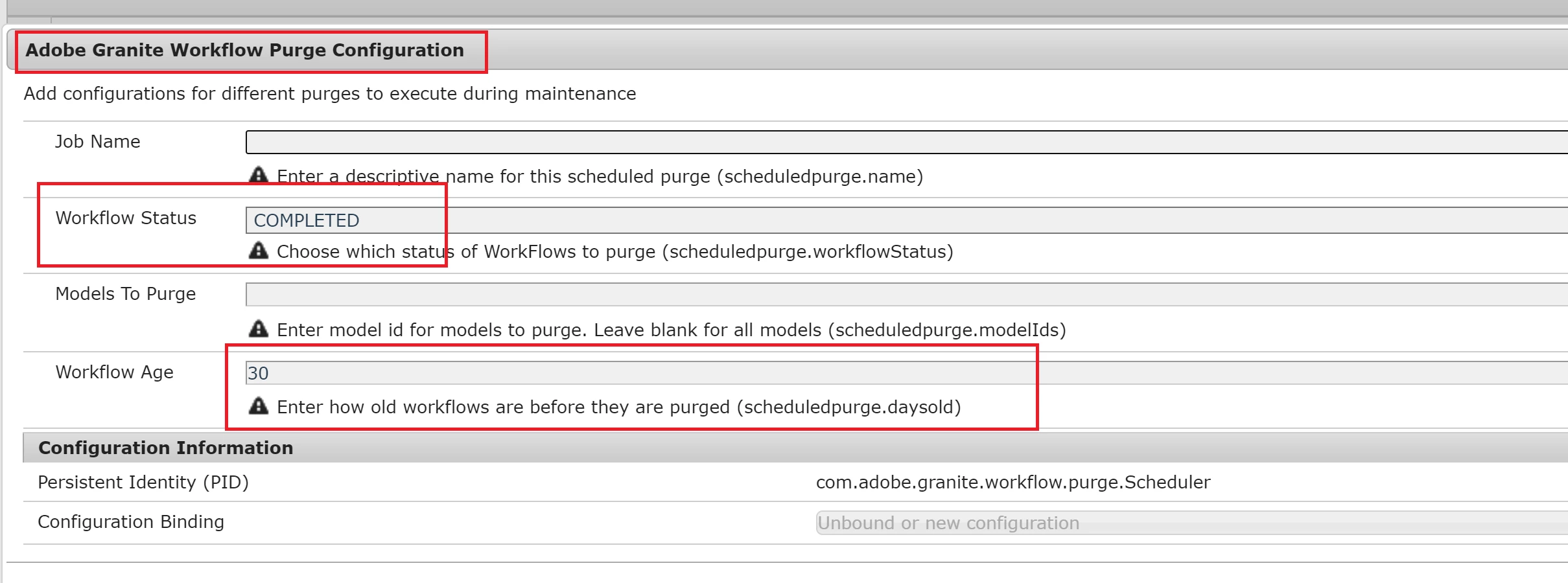

Hi @ronnieforum,
If you are looking for purge based on days old, you can make use of OOB Workflow Purge
Tools -> Operations -> Maintenance -> Weekly Maintenance window -> Workflow Purge -> Configure

Hi @ronnieforum,

@vijayalakshmi_s I am using OOTB workflow purge as you suggested. However, I am seeing that there is already an existing scheduler which looks for all workflow instances in completed state for all models which are 30 days old. My configuration looks for specific models and which are 60 days old.
From logs I can see that the other existing scheduler executes always. How do I make the Maintenance weekly scheduler to use my custom config rather than the existing one.

As it is a factory config, it will execute all instances of purge configuration. Can you check the available instances of purge configuration in OSGI configuration console and confirm your custom entry is available as part of the same.

@ronnieforum  Instead of using workflow remover, you can leverage workflow purge oob for your purpose
https://experienceleaguecommunities.adobe.com/t5/adobe-experience-manager/re-acs-commons-workflow-purge/qaq-p/404924/comment-id/88516#M88516
here you will provide days in configurations "scheduledpurge.daysold"
