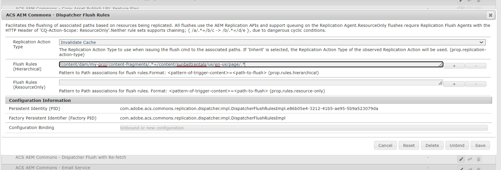

Hi all,
Requirement:
Whenever content fragments are published/replicated, then the particular static page needs to be updated with the updated content fragment automatically in the dispatcher. I have set the rules in the ACS AEM Commons - Dispatcher Flush Rules:
But this is not working. The dispatcher page was still cached and showing the old content.
Can anyone please help me on this?

Best answer by Anish-Sinha
Hi @abirami_sd ,
As per the documentation, you should not use "/*" at the end of the target path. Something like below:
prop.rules.hierarchical=[
	"/content/dam/.*\.(png|jpg)=/content/mysite"
This would clear all under /content/mysite.
In your configuration, you have used
prop.rules.hierarchical=[ "/content/dam/.*\.(png|jpg)=/content/mysite/*" ]  an extra /* at the end of the target path.
Remove it and test. It might fix the problem. Reference Link: https://adobe-consulting-services.github.io/acs-aem-commons/features/dispatcher-flush-rules/index.html

Can you try with DELETE replication action type?

Hi @abirami_sd ,
