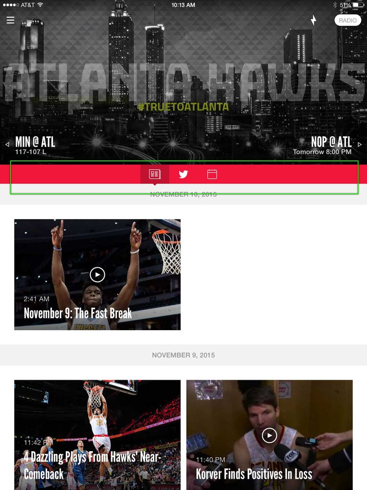

Ive Attached two examples of what I'm trying to accomplish.  The ATL Hawks and The New Yorker, both of which I am wanting Elements/Functions from.
Is there a way to have a Rotating banner at the top and the built-in icons at the bottom with out having it set up as entitlement? and how would I go about that?
My purpose to have the rotating banner at the top is to showcase new products which link to collections or articles.
ATL Hawks APP, they have a tab that is clickable to nav to other pages and a rotating banner above. How did they accomplish that?

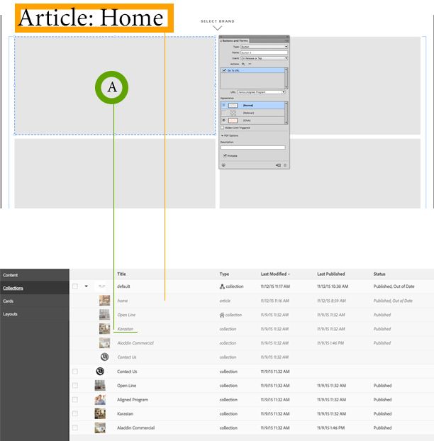

Ok if that is the case, for my example below. How would I make the "Article: Home" the First thing the person see's as the landing page.
In addition to having the Box A  which is on the home article Link to a Collection?
The UI is a bit misleading in this case. Your article will be the first item to appear when you launch the app. The "home" icon appears next to the first collection in your top-level collection, but your home article will actually be the first item to appear when your app is launched.
We recommend using a collection instead of an article as your first launch experience, but you can make an article "home" as you've done. When you view your app, you'll see the article first.
Change the order of items in your collection so the article is the first item in the collection and it should show first. Documentation on links to collection is at Digital Publishing Solution Help | What's new in this DPS 2015 release, doesn't look like Bob has included it in the hyperlink help topic yet.

Reordering them only bumps the article to the top. DPS still wants to make the the closest collection to the top the first collection as home.
I would like to have the Home article as the landing page and the only thing you see once you launch the app and have it function as the main navigation page.

What do you mean by “makes the closest collection to the top” as home? Other than flagging it as such in the content dashboard, it shouldn’t impact the viewer.
If you want an article to drive the main navigation of your app then have the article as the only item in your top-level collection. Remove everything else and it will be the only thing there, and the only thing you see when you launch the app.

There's no need to do that, the TLC always opens to the first item in the list. Put the article first, that's what you'll see.
Neil
I did do what you suggest by deleting all of the collections out of default. This technique did work, and the article shows up first.
The only problem with with deleting all the collections out of default is now I can't have collections show up in the default hamburger menu.
By default even if I put the article first in the stack, it will still make the collection home if there is a collection present. I'm assuming there's not a work around for that yet.
Jonathon,
You can still put the collections in the top-level collection so they show in the menu. Ignore the indicator in the portal saying the collection is "home". It's irrelevant. When you run the app the first thing in your default collection, the article, will show.
Neil
Yes, this Home Icon is confusing. What is the idea behind it?
–Haeme
It's a bug. It should be flagged on the first item in the top-level collection, not the first collection in the top-level collection. Colin and I both asked for it to be fixed
