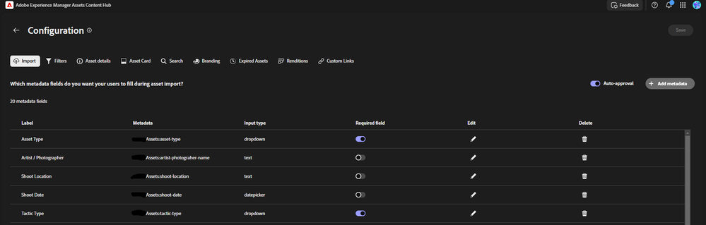

We have a custom metadata schema being applied to all of our assets in AEM and they show as intended there but we are not able to find them under the configuration settings in Content Hub. We can see the OOTB fields but none of our custom ones. We'd like to add them to the asset details, card details, and filters in CH but they don't show up in the drop downs to select.
Has anyone else run into this issue and resolved it? If so, I'd love to hear what your solution was.
