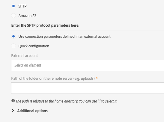

February 22, 2019
Hi Ramon,
Thanks for your response, But if I use file transfer activity to upload the sftp path its not showing the below option.
“ File(s) present on the Adobe Campaign server”
Then how can I upload the processed file into different path. Please find the below screenshot for the same.

February 22, 2019
Hi Ramon,
I have tried the same but no luck, Please find the below WF screenshot
In the first activity i am downloading file from sftp using option "Files present in Campaign server", Then loading file with proper datatype and again tried to upload the processed file to another path via transfer file activity.
But no option found "Files present in Campaign server" whenever choosing file upload.

February 25, 2019
Hi Ramon,
I am not trying with external account, For download/upload i am using this "File(s) present on the Adobe Campaign server". My question for file transfer download option above option is visible, But the same is not visible while doing file upload.
Can you please advise which option i need to use for uploading file in Adobe campaign sftp server.
Sakthi Kumar
bisswangAdobe EmployeeAccepted solution
February 25, 2019
as said there is no such option available. The "Upload file" will take whatever is provided within the workflow transition.
Though as said:
* Use "download files" and specify "file present on Adobe Campaign server"
* This will fetch the file and store it in the temporary folder belonging to the current workflow instance
* In addition, it will be attached to the current transition
* Thus, adding a new "Upload file" afterwards will take that file and send it to SFTP/S3 destination
The only thing to take care of that the data in the transition is not getting overwritten.
i.e. if you have "Load File", it will have the line records in the transition.
Thus in my example above the Fork + AND-Join as by this the file pointer can be kept in the transitions
