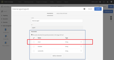

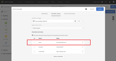

Ex: I have an Email field which is coming from the profile table using a query and I want to pass this email to the external parameters. Please help me in achieving the solution. Please see the screenshots attached for your reference.
1.
2.
In the Image 2, the constant value is passed to the external parameter "Email" declared in the Image 1, So In place of constant I would like to pass the dynamic value which is coming from the inbound transition.
Thanks in Advance.

Unfortunately you can't do so at the moment.
Data from the workflow tables cannot be chose at this location.
Mainly also as e.g. the transition could contain multiple records
