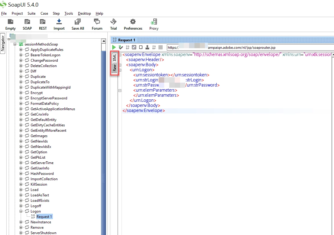

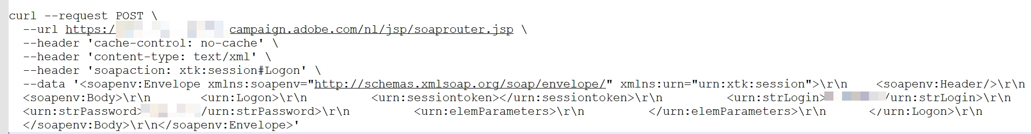

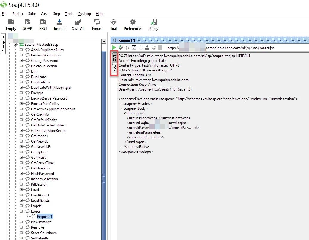

Alternatively, if you wish to achieve by shell script:
As you do have SOAP based API calls, please refer to below screen grabs (using SOAP UI client)
After a successful API call is fired, the client will show all headers required to make an API call using curl, wget, etc.
Using the headers information from the SOAP UI client, a typical curl example:
