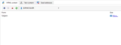

Hello everyone,
I face an issue with one of my real time template
I input the HTML and when done, I want to check with a seed address the preview to see how it looks like but when previewing, there isn't any display : see screenshot below.

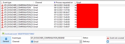

Why is it doing that ? I also try with a simple test HTML, the preview won't show either. (main error is there, not happening with my other templates)
Any idea on how to fix that ? I think there is a reason why when I want to test this real time that I got an error that mention : event not covered.
I make sure that the event type is linked to the template and the template is successfully publish.
Thanks for your solutions.
Kind regards.
Best answer by David_Loyd
Not sure about the preview, but the error logs clearly show the Event is not covered. Meaning the eventType you are sending to ACC does not match what is listed in the eventType enumeration. Perhaps double check those items and republish.
David_Loyd
David_LoydAdobe EmployeeAccepted solution
December 14, 2021

Hello, thank you for your answer. Indeed the event was not covered but now, I face this kind of error (which relate to HTML content)
How can I fix this error ? my code include mctx but I don't know what I can do to resolve that (I try without that and the preview is not showing)
Thanks in advance.
David_Loyd
December 14, 2021
So the error "content htmlContent" means that something in your HTML is not correct. Usually this is because of a personalization tag error <% %> or and If Else statement in javascript. Can you share the code you are using with mctx?
