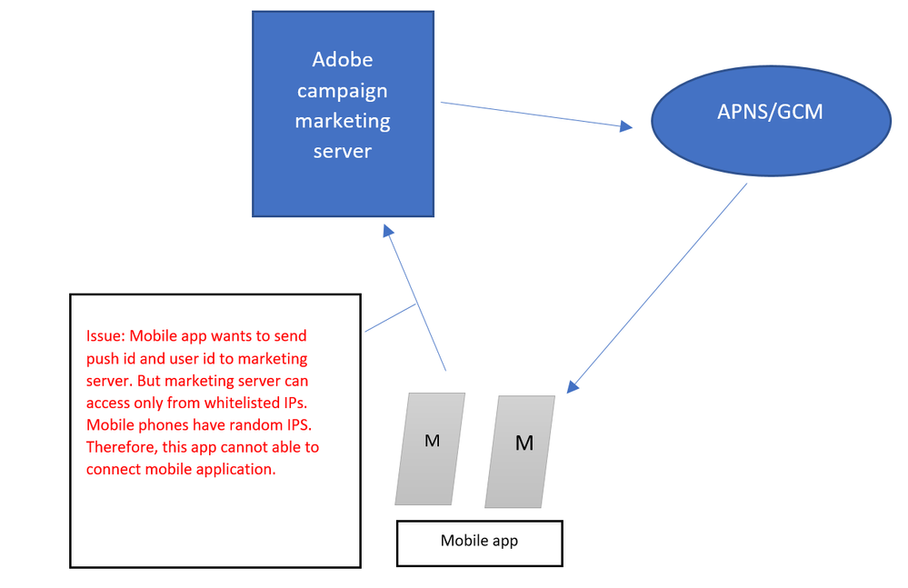

Hello Everyone,
I want to know, how to link the on-premise marketing server of Adobe campaign with Mobile SDK for push notification, if only whitelisted IP can connect with op-premise marketing server.
Do I need to use a middle server between mobile app and marketing server or there is any other solution?

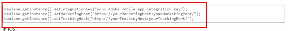

If I will use middle server between mobile app and server, then what should be the value of below variables in the mobile application.
Thanks.

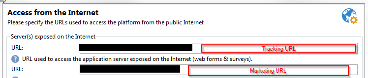

Hi Pravesh,
You shouldn't need to use any additional server for this as far as I know.
If you go to the deployment wizard in your instance by going to tools, advanced, deployment wizard. Then navigate to the 'access from the internet section' and use the URL's highlighted below for the marketing and tracking server.
Dave.

parveshp7822672
January 3, 2019
Hello Amit,
Thanks for the reply.
But, I do not have a problem sending the push notification from the marketing server.
I am facing the issue when receiving the push id from a mobile device to the marketing server. My marketing server cannot receive the request from public IPs.
Thanks.
Parvesh.
Amit_Kumar
Amit_KumarAccepted solution
January 8, 2019
There can be two problems.
The first device is unable to connect with APNS servers to submit the Push id or Second APNS server is unable to establish the connection with the Marketing server. Can you raise a support ticket with Tech Ops? They are better suited to help you as they will have access to logs.
