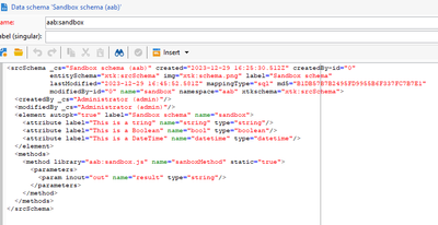

i've created bellow schema with the below method :
The definition of the method is simple, it just returns a string :

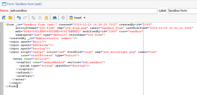

In a form, i trriger the method using a button and store the result of the method in my @string field.
I use a <refresh/> so that the result can be seen on the screen and a <saveView/> so that the change get stored to database
Bellow the definition of my form :

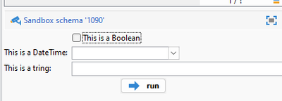

Before clicking the button:
After clicking the button:
