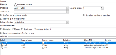

You need to enable the option Consider the consecutive delimiter as one & need to give the single pipe as the column separator.
Below is the screenshot for reference. Hope this helps.

Maybe someone will have better idea but I would suggest that you use only one pipe "|" as a delimiter. This will produce a lot of additional empty columns. Later in Enrichment node just pick the ones you need.
