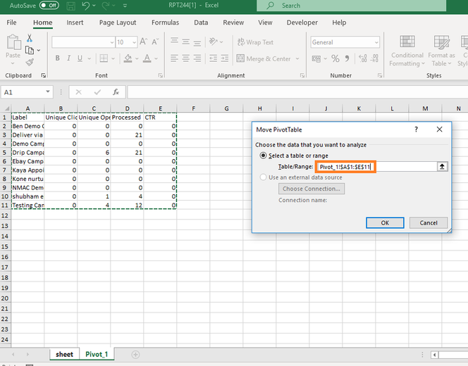

1. Select the pivot table on sheet 1. On selecting the table you will be able to see a tab "PivotTable Analyze" as highlighted in the image below.
2. Click on the "PivotTable Analyze" tab -> "Change Data Source" option -> Select "Change Data Source" from the drop down as shown in the image below
3. A "Change PivotTable Data Source" dialogue box would appear. Select "Pivot_1" sheet and then select the entire data range as shown in the image below:
4. Click "OK". Now switch to "sheet" and you will be able to view the table data.
The reason we are facing this issue is because the table in sheet 1 is unable to locate its data source. By default, the data source is tagged as "Table1" in exportReport.js by Adobe Campaign.
