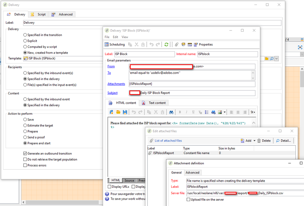

Hi Sri,
If i understand you want to send to an operator the bounced email?
  • If yes, i recommend to use a constant file name and add your personalization in the subject line or content (see screenshot below)
  • otherwise you can add attachment in delivery with the code below if you want the filename with the date
delivery.attachment.add(
  <attachment compressMode="print" filterActive="false" label="YOUR FILENAME"
              nameScriptActive="false" type="normal" upload="false">
      <name>{vars.filename}</name>
  </attachment>)
delivery.hasAttachments = true
David

Hi Sri,
  </attachment>)
David
David Kangni
