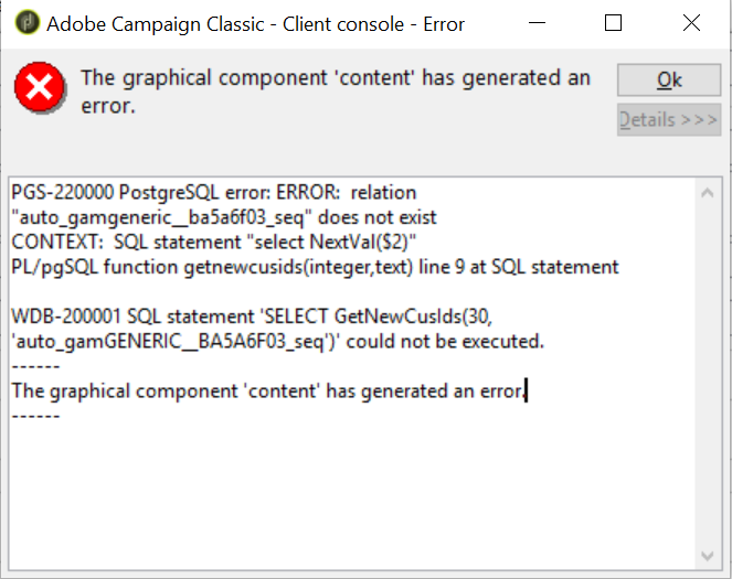

Hi there,
I created a Publication Template using a schema - input form - javascript template configuration.

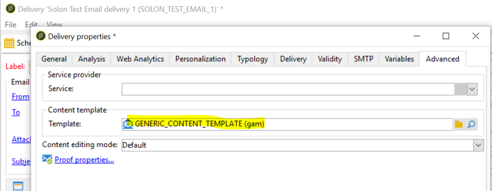

I then added the publication template in one of my delivery templates as seen below:
The issue here is that when i then try to use the input form from within the delivery template to edit the email content, i'm getting the below error:
I can't seem to find anything wrong in my schema/form definitions, both seem to be working fine (individually at least), and although i've worked extensively with Publication Templates in the past, i don't recall experiencing this error before.

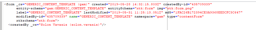

Form definition:

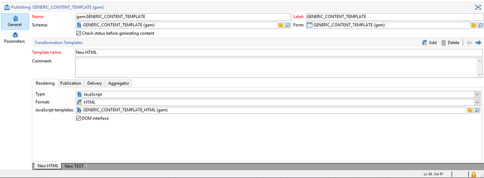

Publication template configuration:

I was using JavaScript template in the publication template. There is an option 'DOM interface'. When I unchecked this option, it worked for me.

Level 8
Can you please share in Schema what's your primary key? Error is more related to You missed to create primary key in your schema.
Kapil
I didn't specify any primary keys, manually atleast. My understanding is that Adobe autogenerates a Primary Key anyways.
I found that i had to manually add the below, and it seemed to have rectified the issue:

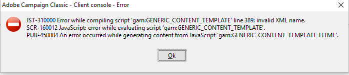

I'm now experiencing another issue though, where when i reference any of the content fields in the Javascript Template by using <%= content.@FIELDNAME %>, i get the following error:
As an example, i'm referencing <%= content.@firstBanner_Alt %> in the Javascript Template, but i get an error when trying to Preview the content. Once i remove that reference, i can preview the content fine. Its obvious from the error that it can't find that XML field, even though the naming is correct.
Reference is the Javascript Template:

Hi solva87,
I have also faced similar issue in content data schema and had to add pksequence in the schema to avoid this.
But now, I am also getting the same error(invalid XML) while using any field in the javascript template with syntax as <%= content.@attributeName %>
Was you able to resolve this issue or can someone help?
I am also getting invalid xml error in my publication template. Did you find a solution for it?
Unfortunately no, i haven't been able to find a solution to this as of yet.
I'd be very interested myself to know why this is happening, as this process is something that i've used in the past and was working fine, so it might be a case of something changing in latest versions of Adobe.
If anyone has any info around this, it would be really appreciated.
