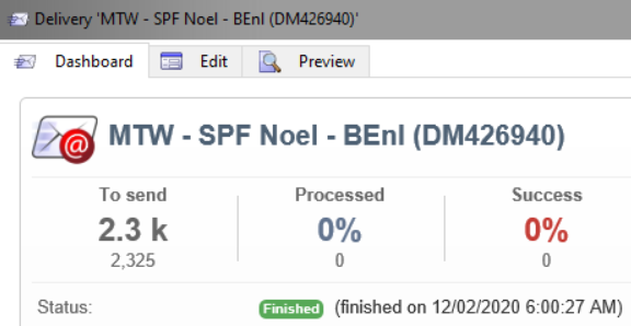

Hello everyone,
I face an issue where I send 3 deliveries to customers and 1 of them don't have data concerning the messages to send process/success ratio. You can see this on the screenshot below.
The results for the first delivery are both equal to 0 and should not be the case.

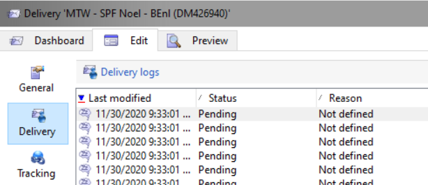

These are the delivery logs. (notice the status is on pending)
And I have tracking logs available so I know that the delivery was send out successfully but display 0 for both success/process.
I check the documentation on this issue and I can confirm that both my technical workflows for the mid sourcing delivery logs and delivery counters are working. I restart them just in case.
I already recomputed the delivery and tracking indicators for this delivery but no update after this manipulation. (I wait at least one hour)
Is there something else I can do ? Strange issue also is that this happened on one of the three deliveries I send out.

prasannakumarmarru
December 2, 2020
I think you should first check with Adobe support if the delivery status is updated in mid instance, if it is not updated on mid, you can take their help to troubleshoot further as the issue is on mid instance. Also you may have to compare the delivery parameters like routing, Affinity among those deliveries, also the delivery status is moved to finished in 2 days and other two are in retry pending, have you changed retry settings or validity settings for this delivery? Because the default retry period is 5 days and I dont think it goes to finished state that fast. Also provide audit logs here so that we may have more understanding.

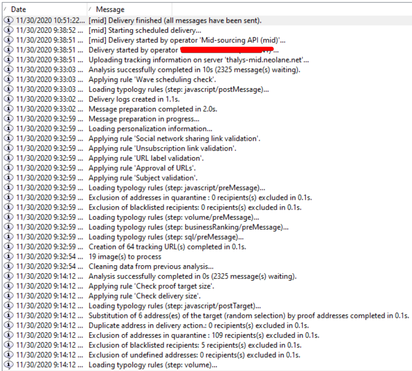

Here is the audit log for the failing deliveries :
Where can I get extra help on this issue if it's coming from the mid instance ?
