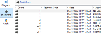

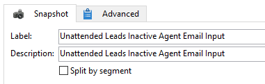

Yes, I was able to get the "Snapshot" activity added to my instance and this is providing the results I desire.
