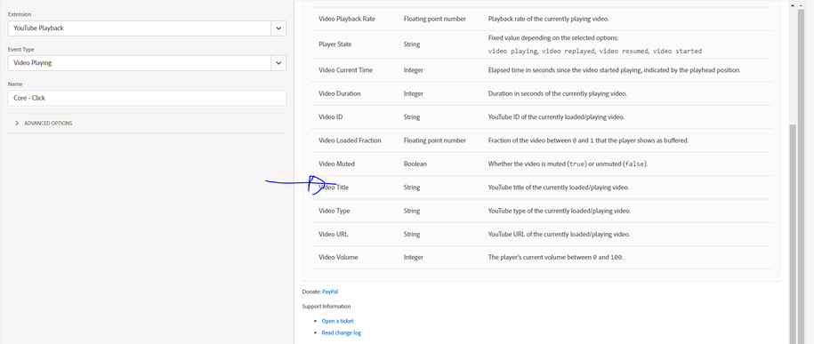

Hello everyone,
I am using Youtube Playback extension to track youtube video. I am able to catch the event but I cannot find the Title of Video if I use %Video Title% data element.
Any suggestion?

Hi, I'm the developer of that YouTube Playback extension.
I've just checked with a test page and could see the video title being returned properly with that same Video Title data element.
Are you using your Video Title data element from within a Rule that gets triggered with one of my YouTube Playback events?

Hello @yuhuisg ,
Yes, I am using the Video Title element mentioned in the Youtube Playback events.
Shall I create the Video Title Data Element or shall i expect will be installed with the extension?
