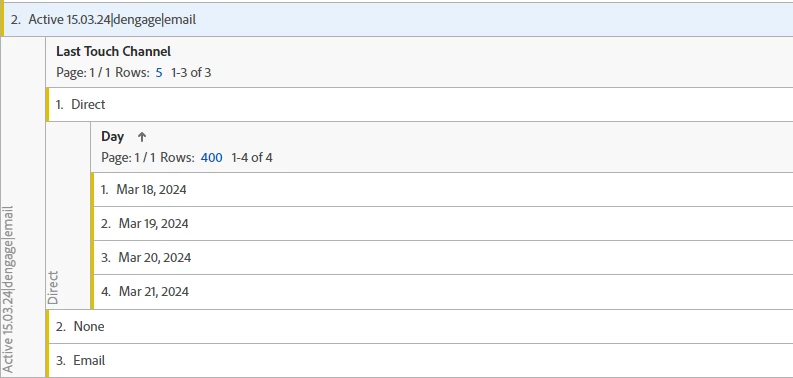

i created some processing rules to define the last touch channel of my tracking code.
I build my tracking code in tealium, in the form of "utm_data1|utm_data2|...|utm_medium" and i send it to Adobe. My medium usually are in the type of "banner" - "email" ecc..
But for example i declared a processing rule that check if the tracking code contains "email" or "Email" and it's before the rule for the Direct traffic.
But when i split the tracking code for the last touch channel a tracking code of this type: Active 15.03.24|dengage|email ends up in the Direct channel, some in "None" and just a few in my Email marketing channel!! How it is this possibile?
I only check data with a range of date after my modifications to the processing rules because i know that if i make a change to them it is not retroactive, but also after week after the processing rules update i see this type of situation....
help me pls!!

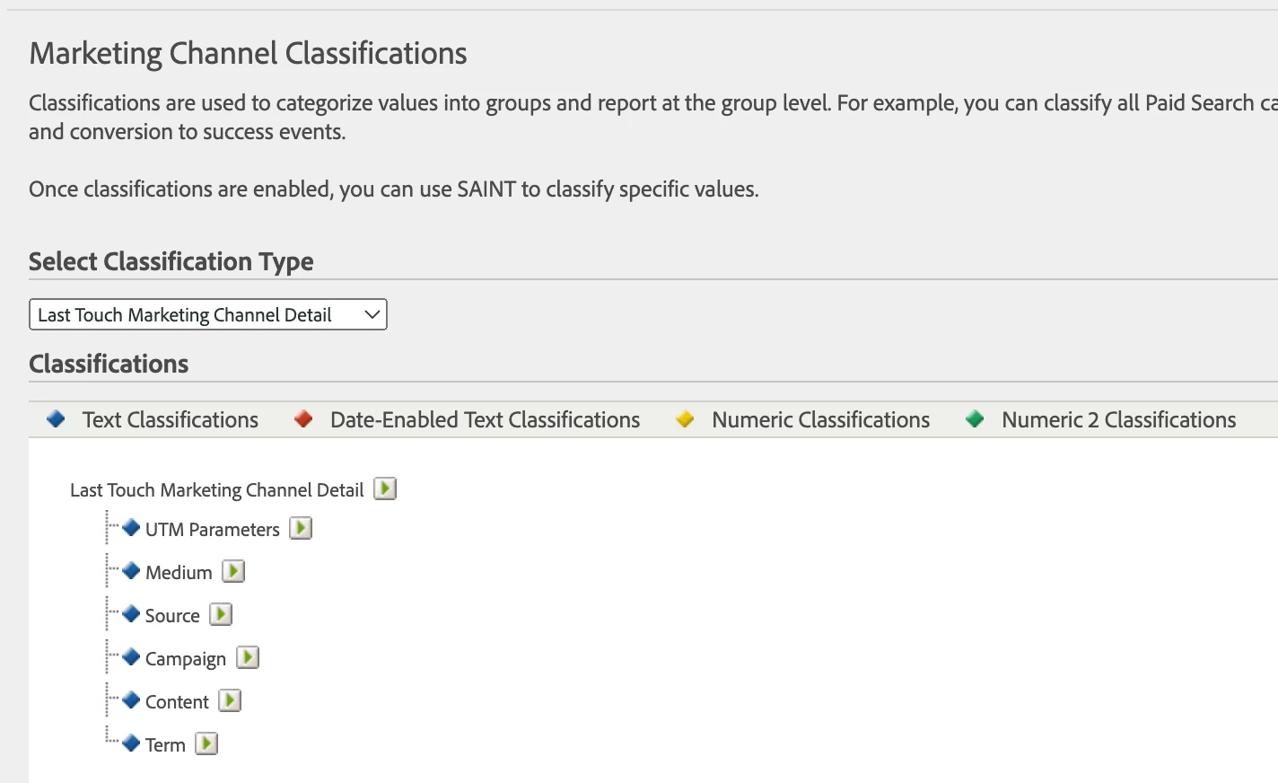

First create the variables for Last Touch Marketing Channel Details in Marketing Channel Details (Report Suites>select report suite>Marketing Channels>Marketing Channel Classifications).

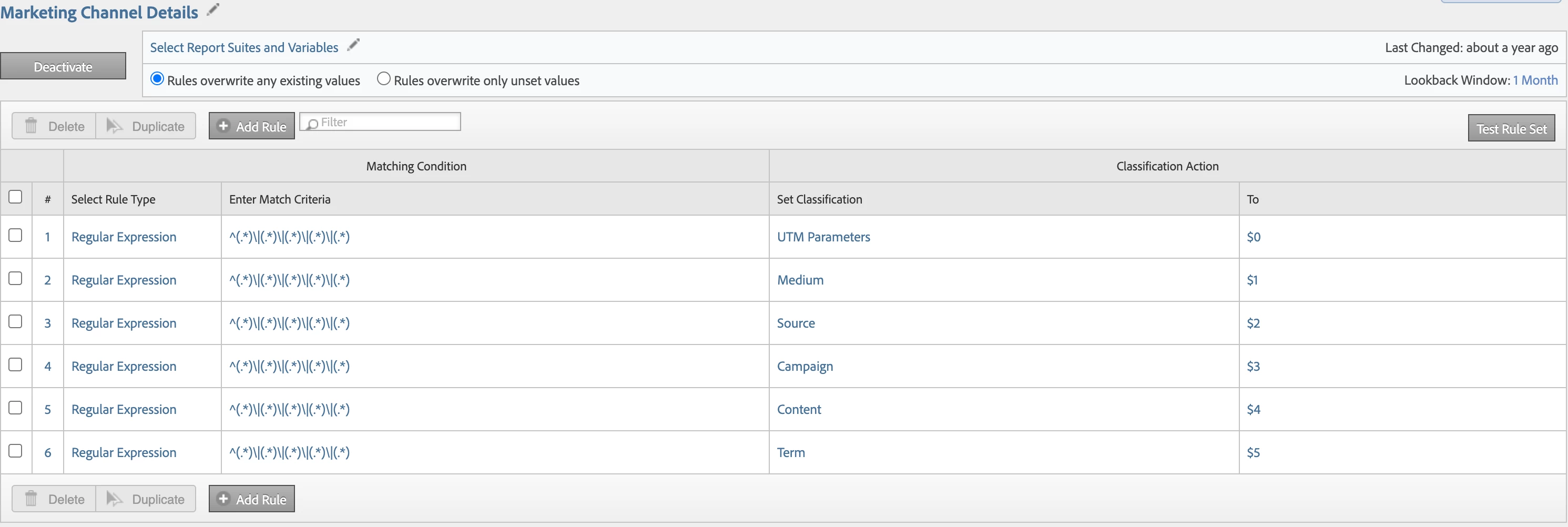

Next, in Classification Rule Builder, create a set of rules that would assign values based on the position:
When in workspace, break down Last Touch Channel by Last Touch Detail instead of by Tracking Code (eVar0).
