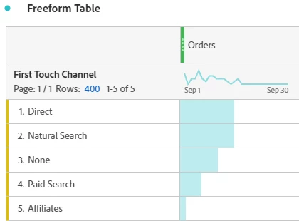

The First Touch Channel seems to be showing correctly (as below):

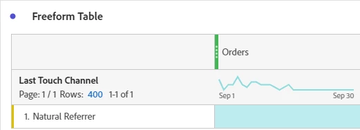

However, my Last Touch Channel seems to be showing as just "Natural Referrer" and I'm not sure why:

Dear George,
Interesting! You have 'Natural Referrer' in Last Touch but unable to see the same in 'First Touch' which means your Marketing Channel 'Natural Referrer' is overriding every other channel.
Can you share the Marketing Channel rule for Natural Referrer? Guess some problem with the referrer i.e. Your internal domains were bucketing under your channel by mistake. Once we see the rule, we can help you.
Strong intuition is that your internal filters are not defined properly along with the Marketing Channel set-up.
Thank You, Arun.
Dear George,
Thank You, Arun.

Perfect. Make sure that the 'Natural Referrer' rule is after all the rules like 'Natural Search', 'Paid Search' etc. If it is at the top of the other rules, credit will be given only to the 'Natural Referrer' because Marketing Channel works like a Waterfall Method.

As @PratheepArunRaj mentioned, it's certainly an issue in the Marketing Channel Processing Rules for the "Natural Referrer" channel as it's overriding on every Hit. You may want to review it.
