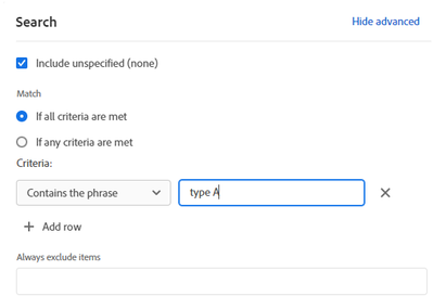

I'm using a table filter,  basically i have listvar that captures a list of products with different supplier code, product type.
When a visitor lands of a hub page that shows different product types, they click on a specific product type link, the next page is where the listvar is tracked which fires that product type (product A).
Now I'm trying to get visits and page views for a specific product type but the views are way more than I'd expect to see.

Are you using any segment where you have a or condition? Or other filter. It is hard to guess the reason by looking at the data solely. But i can think of the three reasons
1. De-duplication
2. Segment logic
3. Implementation issue on product page.
juliusonyancha
July 29, 2024
No segment applied. Just a listvar dropped into a freeform table then used a filter
