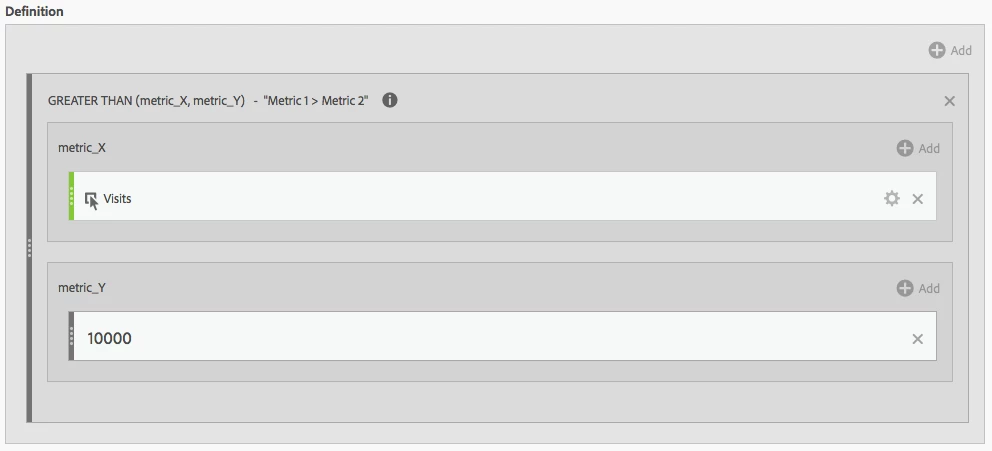

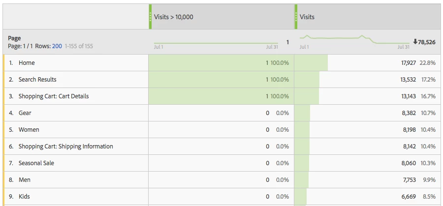

I'm curious what you're looking to do with this filter, once you have it applied.
Right now, your best option is to leverage Calculated Metrics and sort by them:
Which would result in:

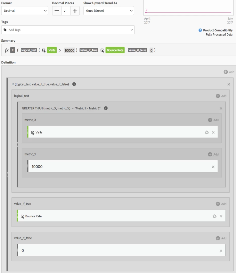

You could also leverage a combination of the IF and GREATER THAN functions if this is your goal. For example, if Visits are greater than 10,000, show Bounce Rate:

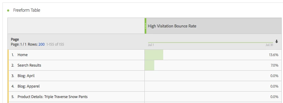

Does that help get you where you're looking to go?

I think the If Then Else might work for what I need. Basically, I have a calculated metric which works out a % of calls generated from each page (Calls / Visits). I want to create a report which I can order by the % column, but exclude any pages with less than say 100 visits or so.
Again, this seems like such a basic thing, while creating the If Then Else might work, it feels like a more complex solution that it should need to be. I’ll give it a try though.
