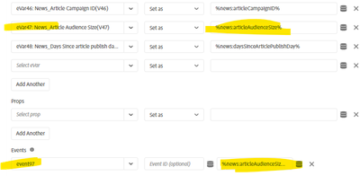

When we are taking occurrences as metrics. we are getting "unspecified" value in report. but when we applied as "instances" as metrics we can't see "unspecified" value in report.
what could be the reason? is it because the evar is expiring on visits and the evar value is persisting on post pages after the hit?
evar97 setting :
launch configuration
